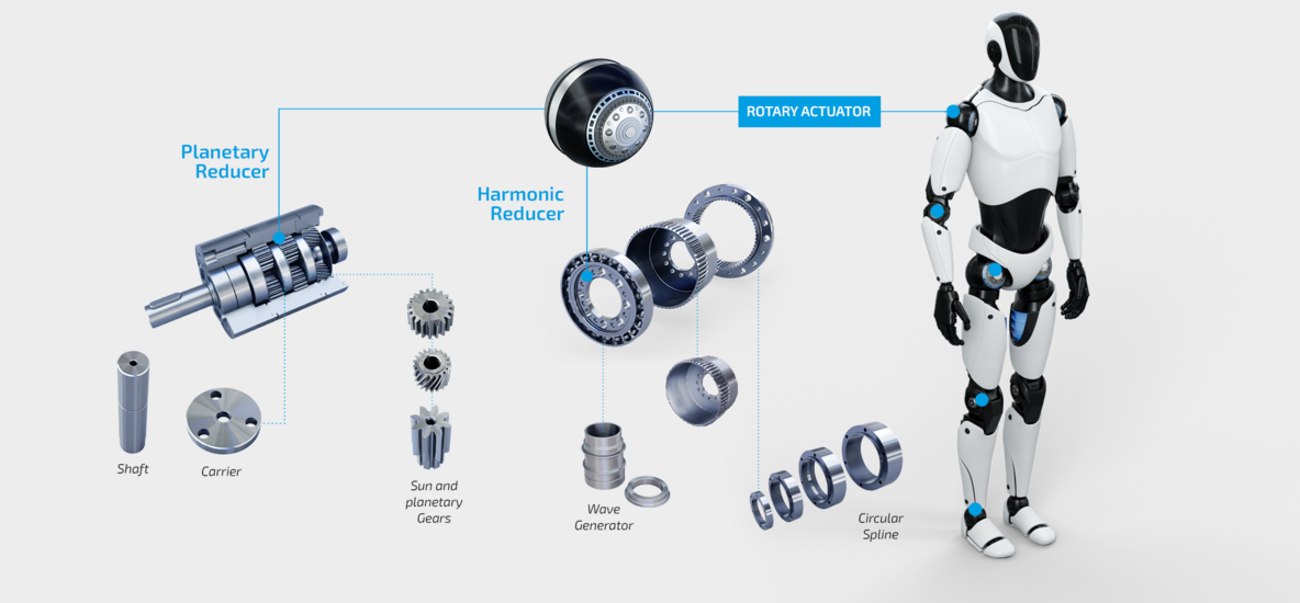

Current humanoid robots require at least 14 rotary actuators distributed across the major joints: three units in each shoulder region for complex arm movements, one unit each at the elbow joints, two units in the hip region for rotation and lateral flexion, and additional units at the knee joints of the legs. As development progresses toward fine motor skills in the hands and more complex ankle joints, this number continues to rise.
Humanoid robot with planetary gearboxes on all major joints. Detailed views of the rotational actuators.
Humanoid robot with 14 rotational actuators at the shoulder, elbow, hip, and knee joints. The detailed views show planetary gearboxes and strain wave gears as drive components.

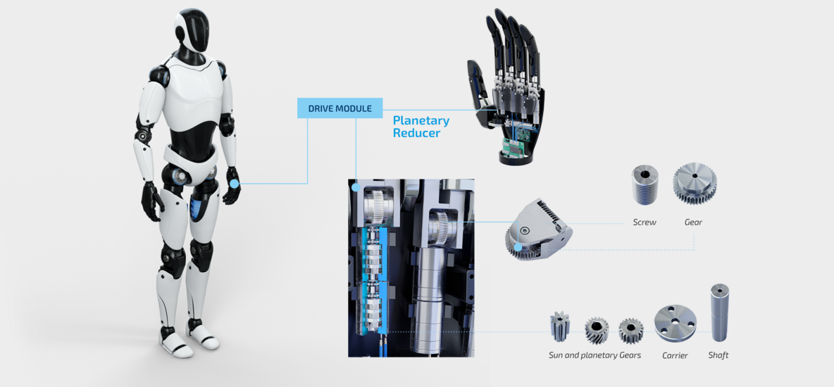

The gripper hands of humanoid robots represent a particularly interesting application. These compact mechanisms often use miniaturized planetary gears in combination with hollow-shaft motors or ball screws to achieve the fine motor control required for manipulation tasks.
Robotic hand with drive module and gear components for finger movement
Structure of a gripper hand with drive components: hollow-shaft motor and planetary gearbox

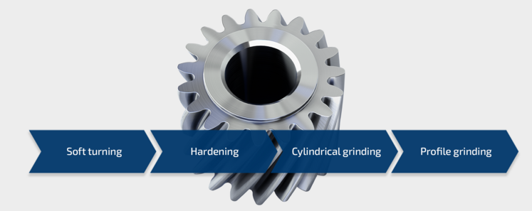

Alternative manufacturing process: grinding from solid stock
Geared components with small modules can be manufactured particularly cost-effectively using an alternative manufacturing process. In this process, the gear cutting is performed directly from solid material after hardening. Pre-gearing is completely eliminated, as the hardening depth is sufficient for small modules to cover the entire tooth geometry. The process chain is thus shortened to:
Achieving Grade 4 quality prior to hardening
While Class 5 gear quality represents the industry’s entry threshold, emerging applications in humanoid robotics increasingly require Class 4 quality prior to the hardening process. Since hardening typically degrades gear quality by one to two classes, this requirement is crucial for ensuring a reliable Class 5 or better on the finished component after heat treatment.
