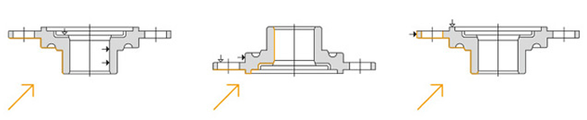

The flange is machined in three clamping operations via three VL 2 lathes, linked with L / U automation and flip-over units.
Complete machining in six clamping operations
OP 30OP 20OP 10
Smoothing, outer contour
Smoothing, plane surface
35 sec.
Beveling and turning
Face turning
Turning, inner contour
Turning, inner plane surface
34 sec.
Turning, plane surface
Beveling and face turning
Drilling
Beveling, inside
34 sec.
Production system for flanges
Production system for flanges with VL lathes
Complete machining of flanges
Complete machining of flanges in three clamping operations
