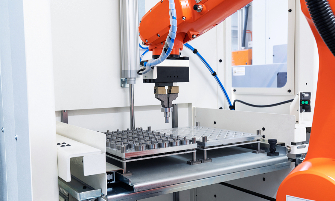

Interlinking using a CRC Robot Cell
The principle: EMAG interlinks its machines with very different robot solutions. The parts are fed to the robot, for example with feeding and out feeding conveyors, palletizers or drawers – the robot utilizes these systems to pick up new parts or deposit finished ones.
CRC Robot Automation Cells
