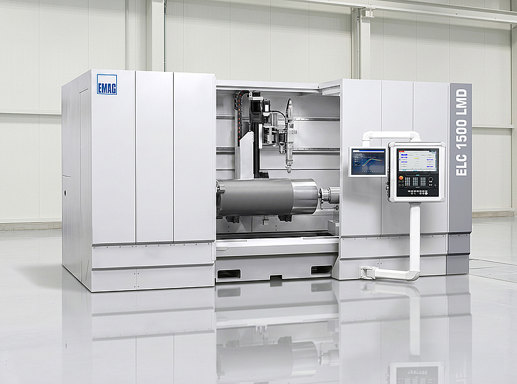

EMAG ELC 1500 LMD – High-performance system for laser cladding
The ELC 1500 LMD was specifically designed to efficiently laser-clad workpieces weighing up to 2 tons and measuring up to 1.5 meters in length. This makes the ELC 1500 LMD ideal for components such as wind turbine main shafts or axles, which are very large and massive. Thanks to a reinforced machine base and a stable tailstock, even such heavy components can be clamped with precision and moved safely during coating.
Exterior view of the EMAG ELC 1500 LMD for laser metal deposition of large components for wind turbines
The ELC 1500 LMD from EMAG: High-performance system for laser metal deposition of heavy drive components in wind power technology
The ELC 1500 LMD utilizes state-of-the-art laser and drive technology. At its core is a process optics system that—driven by up to four NC axes—positions the laser beam with high precision. Specifically, this means the optics can be moved in the X, Y, and Z directions and additionally angled to optimally follow every point on the component. This multi-axis movement greatly increases flexibility: even complex contours or hard-to-reach areas (e.g., the inner surfaces of large bearing shells) can be reliably coated, as the beam can always strike at the correct angle. The repeatability of the positioning is extremely high—deviations from layer to layer are minimal, ensuring consistent results.
 Ergonomics and integration were also taken into account in the ELC 1500 LMD. The machine features a spacious work area that is accessible from the front. Large components can be easily loaded and unloaded using a crane or lifting aids (manipulator). Maintenance work on the laser or optics is facilitated by the open design . All necessary components—from the beam source to the extraction system for smoke and particles—are integrated into the system design and can be flexibly arranged. This means the complete laser cladding solution comes from a single source and requires only a suitable location in the production facility. Cooling systems for the laser as well as protective enclosures are part of the system, ensuring safety and reliability.
