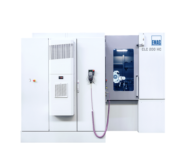

Vertical and horizontal hobbing machines from EMAG SU
Vertical hobbing machines
The vertical hobbing machines can be equipped with an NC-controlled 2- or 4-station ring loader. Loading using a robot is also possible. Deburring and chamfering units are also optionally available. Skiving, finish milling and the machining of non-ferromagnetic workpieces with additional options are also possible. Gears, gear shafts and worm gears can thus be produced cost-effectively on these machines.
Horizontal hobbing machines
Thanks to the horizontal workpiece axis, these machines offer outstanding set up possibilities. They are suitable for gear cutting and long shafts and are therefore highly flexible. Loading can take place manually or with an automation system.
Horizontal profile milling machines:
These machines are specially designed for the machining of worms and rotors and have high torques on the table and milling spindle drive. A side milling cutter is used to cut the gear tooth gap. HSS and carbide indexable insert cutters can be used. These machines are capable of machining both high profiles and long workpieces.
