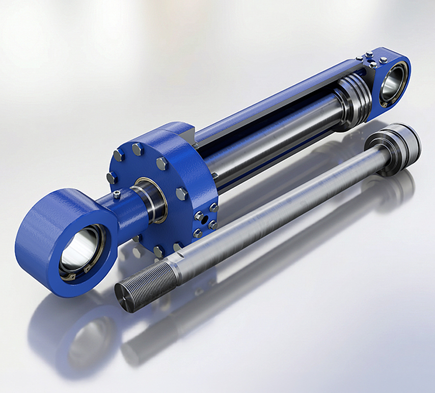

Laser metal deposition of hydraulic cylinders
Hydraulic cylinders, and in particular their piston rods, are exposed to moisture, dirt, pressure spikes, and mechanical wear. During laser metal deposition, a metallurgically bonded protective layer is selectively applied to the stressed surface. This increases resistance to wear and corrosion and extends the service life of the component.
