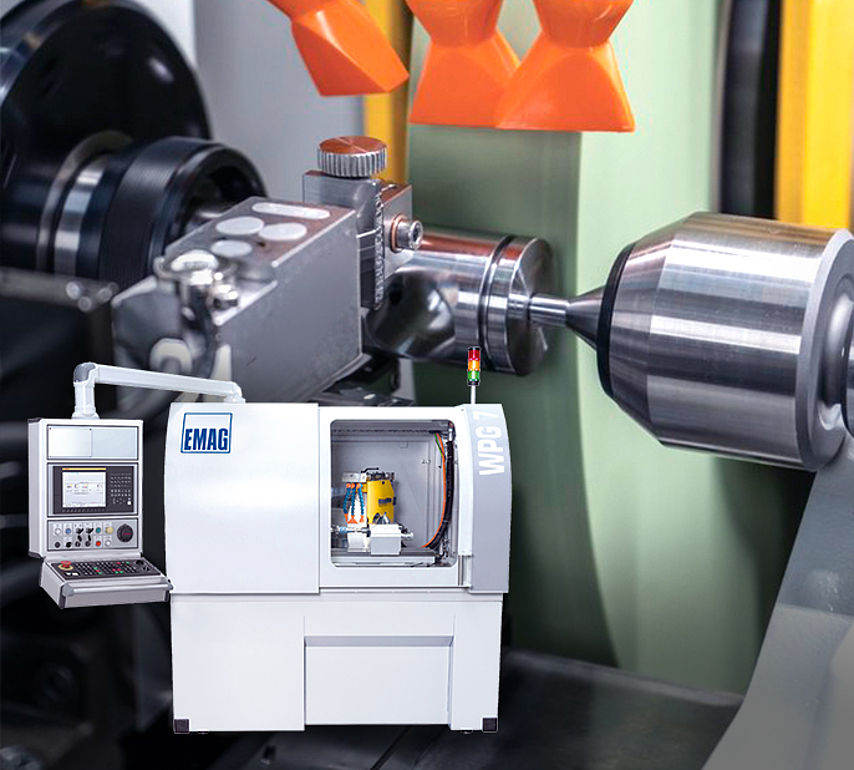

WPG 7 – Compact OD Cylindrical Grinder
The WPG 7 combines precision, flexibility and a compact footprint – making it the ideal solution for smaller components up to 250 mm in grinding length. Built for manufacturers who demand consistent performance with minimal setup and floor space, the WPG 7 includes features that competitors list as options – all standard.
  • Compact footprint: 1.8 x 2.4 m
  • FANUC Oi-D control system
  • Max part length between centers: 380 mm / 15 in.
  • Grinding wheel Ø500 × 80 mm (CBN or aluminum oxide)
  • Optional integrated gantry automation for unattended production
  • Standard in-process gauging, crash detection, mist extraction, filtration
Flexible Configuration:
The WPG 7 is available in 0° (straight) and 30° (angular) grinding versions, giving you the flexibility to match your process requirements and floor space – whether manual loading or full gantry automation.

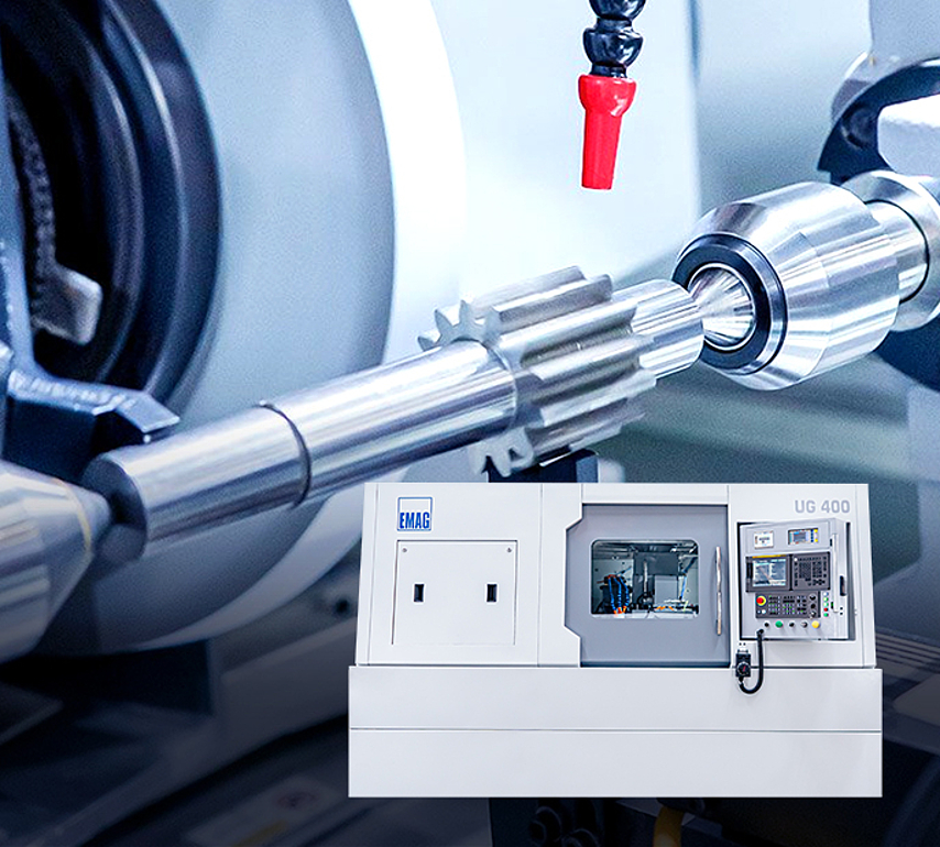

UG 400 – Universal Cylindrical Grinder
One machine for internal and external grinding. The UG 400 handles complex shaft and bore geometries in a single clamping, for toolmaking, gear manufacturing and precision components.
  • Grinding length: 400 mm / 15.7 in
  • Direct-drive grinding spindle up to 11 kW with swiveling B-axis
  • Workhead swivels 0° to +30° for taper grinding
  • FANUC 0i-TF Plus control
  • Suited to aerospace, defense, hydraulic and gear components

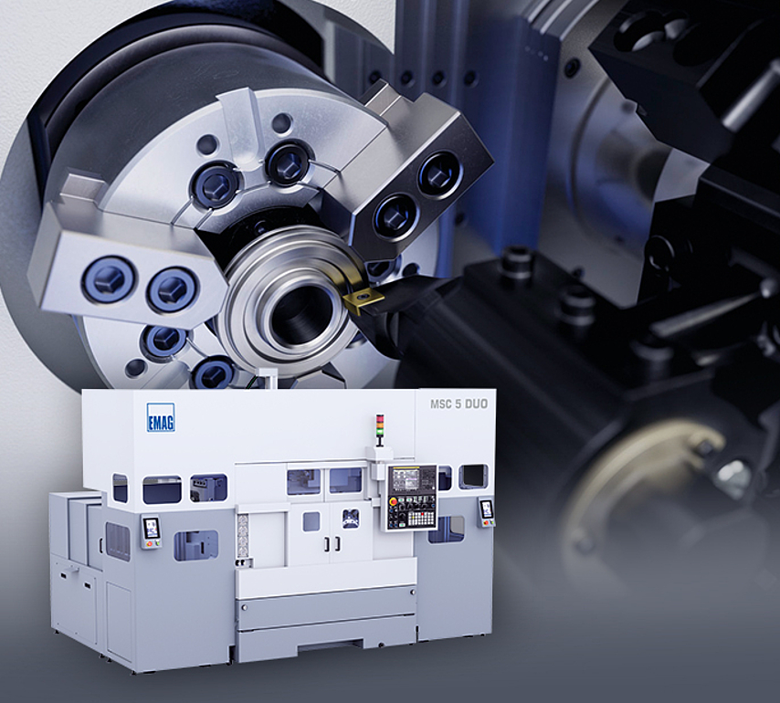

MSC 5 DUO – Twin-Spindle CNC Lathe with Integrated Automation
The MSC 5 DUO has two spindles, two turrets and a built-in gantry loader. It machines both sides of a chucked component in one cell, and its integrated stacker keeps the machine running unattended between operators.
  • Twin spindles with 2 x 8-station servo turrets
  • Integrated 3-axis gantry loader with part turner
  • Integrated parts stacker within the machine footprint
  • Turning diameter up to 120 mm; chuck size up to 210 mm / 8 in.
  • Up to 4,500 rpm, FANUC 0i-TF Plus control
  • Ideal for automotive, hydraulic, pneumatic and medical components

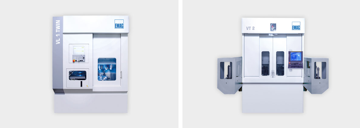

Front view and workarea of VT 2
VT 2 – Vertical Turning Center for Small Shafts
The VT 2 is purpose-built for shaft machining, with high precision and repeatability for medium-batch production with quick setup.
  • Max Workpiece Ø: 100 mm x 400mm length
  • Spindle Speed: 5,000 rpm

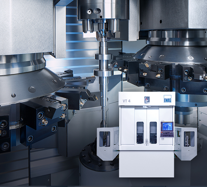

VT 4 (Extended) – Vertical Turning Center for Shafts
The VT 4 turns shafts from both sides at once. Two turrets machine simultaneously on four axes, and grippers built into the turrets load and unload parts automatically.
  • Workpiece: up to Ø200 mm x 750 mm (850 mm w/out automation) / 8 x 30 in
  • Spindle: 38 kW / 51 hp, 250 Nm, up to 4,500 rpm
  • Two 11-position turrets with integrated workpiece grippers
  • Part changeover in about 6 seconds
  • Ideal for transmission, rotor, pump and engine shafts

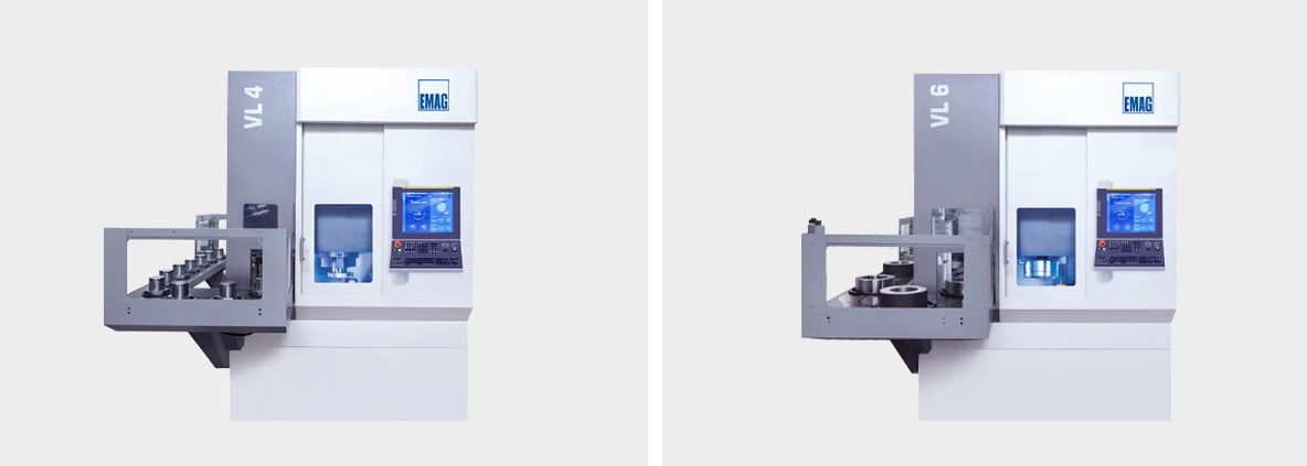

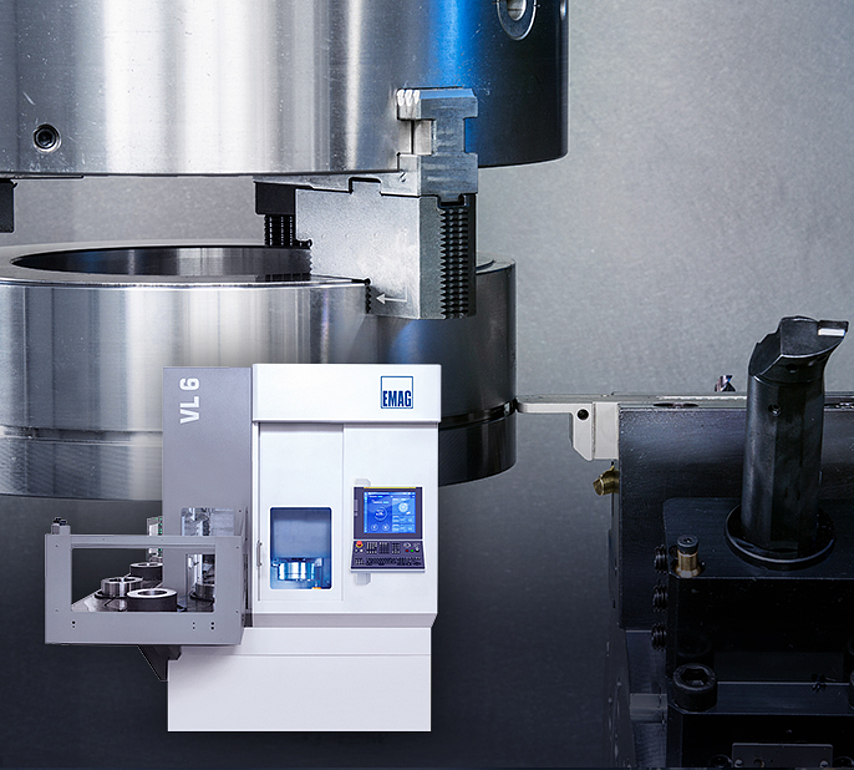

VL 6 – Large-Capacity Vertical Turning
Handles larger components up to 300 mm Ø with power and precision. Built for versatility and reliability in demanding production environments.
  • Spindle Power: 39kW / 52hp

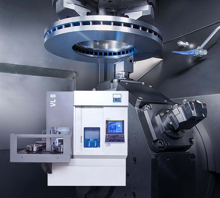

VL 8 – Vertical Pick-Up Turning for Large Chucked Parts
The VL 8 brings EMAG’s self-load pick-up automation to heavy parts up to 400 mm in diameter. Its spindle picks raw parts from the conveyor and returns finished parts, with no separate loader. The result is short chip-to-chip times in a small footprint.
  • Workpiece: up to Ø400 mm x 300 mm / 15.5 x 12 in.
  • Chuck diameter up to 500 mm / 19.5 in.
  • Main spindle: 47.5 kW / 64 hp, 780 Nm (40% duty cycle)
  • MINERALIT® polymer-concrete base for vibration damping and tool life
  • Ideal for truck brake drums, wheel hubs, differential housings and 120 mm ammunition components
  • Live tooling available

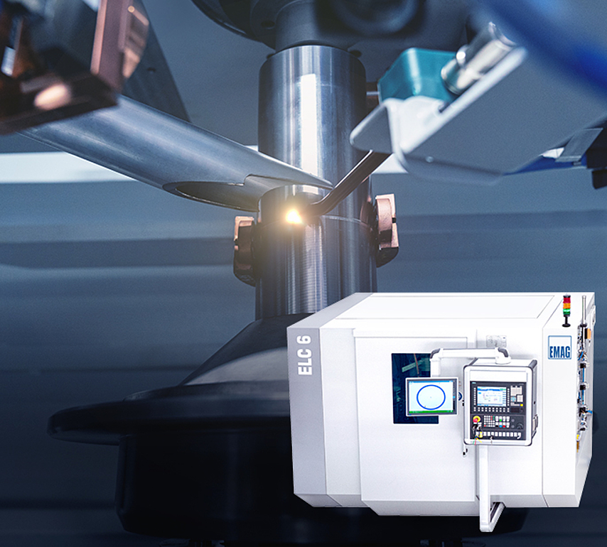

ELC 6 – Production Laser Welding System
The ELC 6 is built for high-volume powertrain production with round welds. A rotary indexing table loads one part while the next is welded, keeping cycle times short.
  • Workpiece: up to Ø300 mm x 300 mm / 12 x 12 in.
  • Axial welding Ø 75–200 mm; radial welding Ø 75–250 mm
  • Welding clamping force up to 10 kN (30 kN optional)
  • Fixed lens / moving workpiece design for operating safety
  • Mainly electric drives, with no hydraulics, for lower operating costs
  • Ideal for differential housings and e-motor rotor shafts

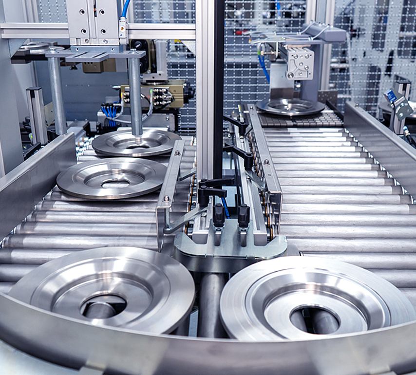

Automation Options
Reduce labor | Improve Consistency | Scale Output
Every stock machine can be paired with EMAG’s smart automation systems:
  • TrackMotion – Linear automation for part transfer and cell linking
  • Basket Stacking Systems – Compact, efficient loading for small parts
  • Gantry Automation – Ideal for grinders and turning centers
  • Robot Interface – Seamless integration for flexible automation cells
