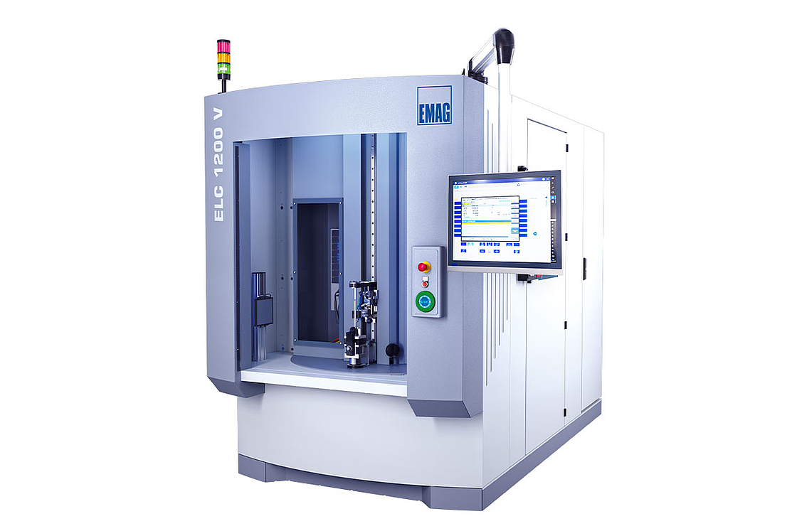

ELC 1200 V Vertical Laser Processing Machine for Shaft Components
The vertical laser processing machine ELC 1200 V is designed for workpieces up to 1200 mm in length and impresses with its fast processing, a small footprint and extreme ease of operation. In addition to laser welding, other laser processes such as laser cleaning and laser hardening can be used on this new machine.
ELC 1200 V Vertical Laser Processing Machine with EDNA HMI for easiest operation
The ELC 1200 V offers maximum flexibility in production. The 3-axis laser lens is NC-controlled and can be configured to meet a wide variety of individual requirements.
In combination with the NC-controlled C-axis of the clamping device, the welding lens can also produce interpolated welds. This means that, for example, a quick conversion for laser welding of families of parts can be implemented without any problems. The clamping system is, of course, just as flexible as the laser lens.

Ventajas ELC 1200 V
  • The vertical machine requires only 4.3 square meters of floor space.
  • The new EDNA HMI makes it easier to operate and program the ELC 1200 V.
  • The loading and unloading by rotary indexing table takes place parallel to the machining time. The machine practically never stands still.
  • The laser lens has an X-axis and a Z-axis, as well as an additional B-axis for rotating the laser lens.
  • The ELC 1200 V vertical laser processing machine is designed for workpieces with a length of 50 to 1,200 millimeters.
  • The machine can be operated both manually and fully automatically.
