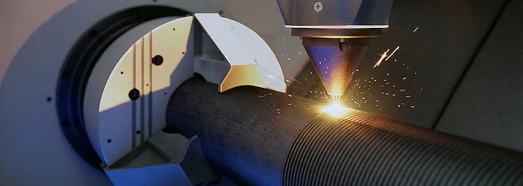

Hydraulic cylinders and laser metal deposition of a piston rod on a rotating workpiece
Laser cladding process for hydraulic cylinders. The laser beam performs precision melting of metal powder onto the surface.

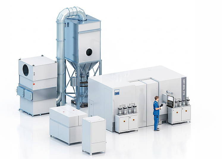

The systems feature integrated sensory equipment for process monitoring, which has proven itself repeatedly in the highly demanding, safety-critical coating processes for brake discs. The powder conveyor, laser source, cooling unit, and extraction system are integrated into the machine concept as a complete package.
EMAG ELC 1500 LMD laser cladding system with integrated laser source, extraction system, cooling system, and powder conveying
Overall view of the EMAG ELC 1500 LMD for laser metal deposition on shafts and piston rods. The system includes a laser source, cooling unit, powder conveyor, extraction system with pre-separator, and control panel.
