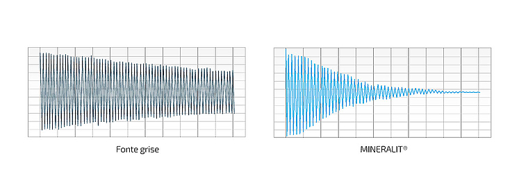

The MINERALIT® machine base as a quality factor
The machine base of the VL 100 GT is made of MINERALIT® polymer concrete. This material offers eight times higher vibration damping compared to conventional cast iron. For the user, this means higher surface quality of the machined workpieces, longer service life of the grinding tools, and overall more stable process control. Especially in fine machining, where surface values in the range of Rz < 1.2 µm are required, the vibration damping effect of the machine base is a decisive quality factor.
Diagram: Vibration behavior of MINERALIT® compared to cast iron – higher damping for precision finishing.
Comparison of the vibration behavior of MINERALIT® versus cast iron. The polymer concrete machine base of the VL 100 GT dampens vibrations eight times more effectively – a key quality factor for precision machining.
